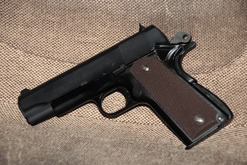

    Here is the pistol, as it comes from Western Arms.
    As you can see, the pistol comes with the short GI style sights and the short grip safety, which had a tendency to pinch the web of my hand when the pistol is fired. Well, all these are now changed.

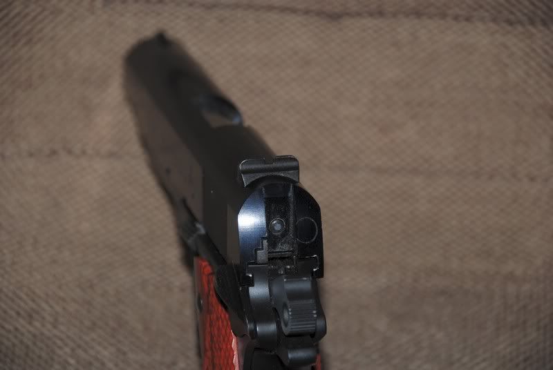

    The pistol is totally rebuild. The grip safety is now the scalloped Commander grip safety.
    The sights have been replaced by the Colt High-Profile ones.

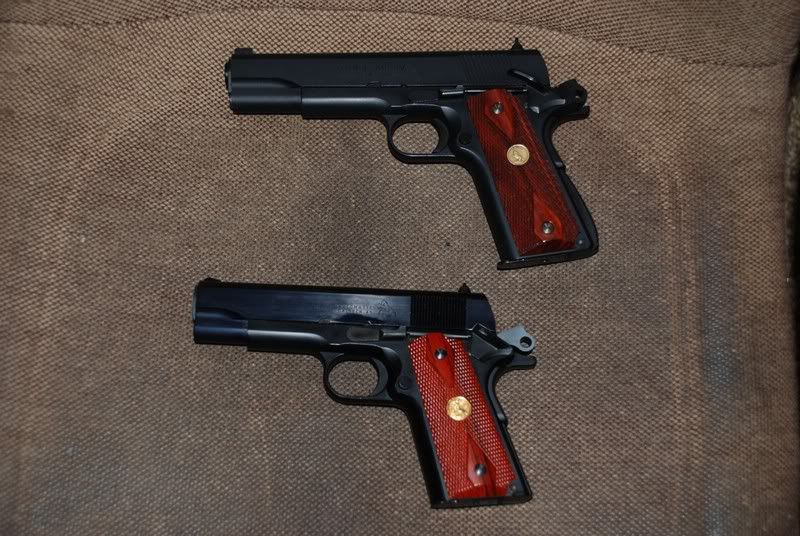

    The second pistol that emerged from this mix-and-match, was a Colt CCO, in other words a Commander slide matted to an Officers frame. You can see it here, compared to a Government model.
    The pistol was produced using the Officers frame from the pistol Mike send me, and the metallic Commander slide I already had.

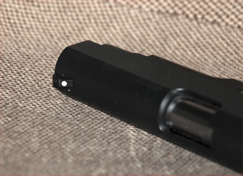

    A side effect of this marriage is the fact that the pistol has the lowish sights.
    But the rest of the pistol is exactly the way I like it. Scalloped grip safety, a very nice set of grips, a round Commander hammer, the tear-drop thumb safety and the weight is very close to the real gun one. Just the way I like it. Someday, I'll have my gunsmith machine the aluminum slide and install a set of real High Profile sights on it.
