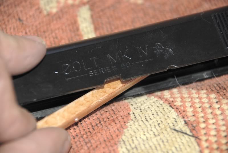

    Then I tried the slide on the frame.
    Well, it didn't even go on. Actually it did go on for about 1 cm only and got stuck. The frame needs to be fitted to the slide, so out came the files and I started working on the rails. After about 4 hours of work, the slide could move through the entire length of its travel without any binding. Now I know why custom gunsmiths charge you the money they do.
    Here is the end result.
    No, that scratch inside the cocking serrations was NOT done by me!

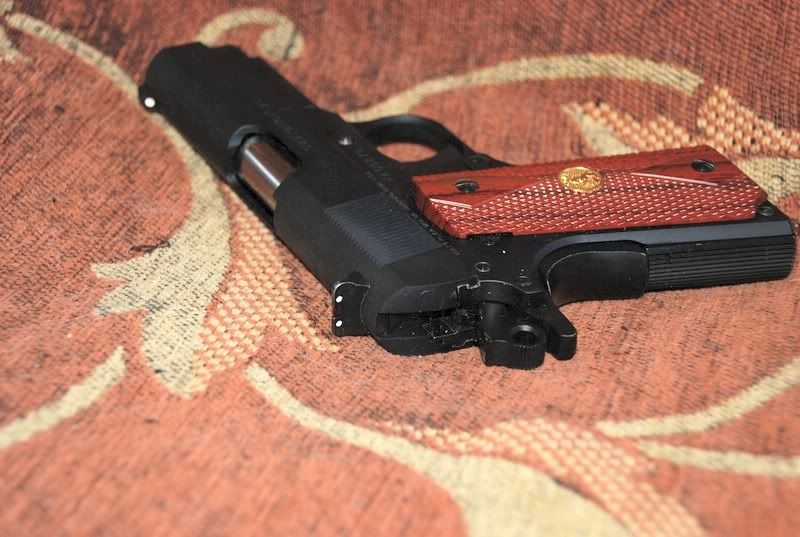

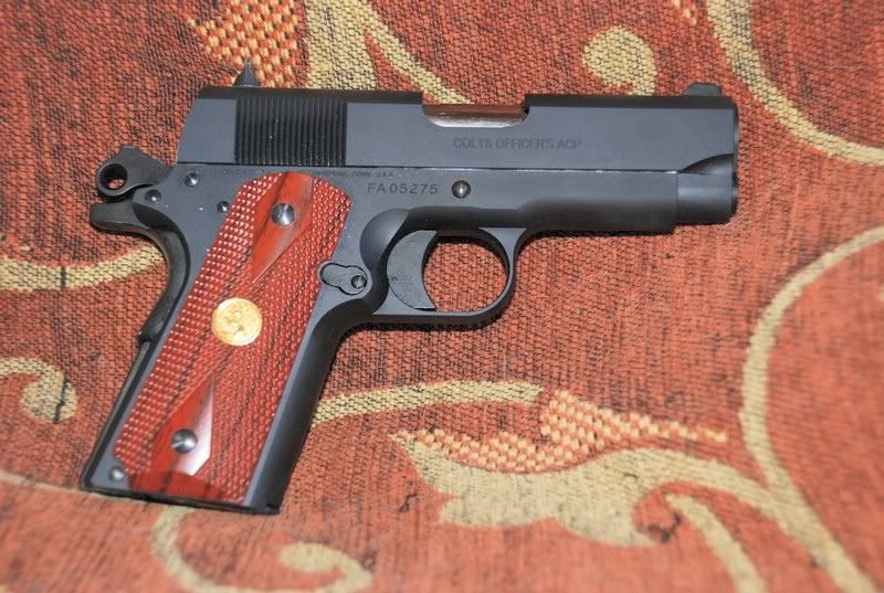

    As you can see, this is a sweet little pistol. The silverish hammer has been replaced with a blue one from the Novak pistol (I think I am going to use that Novak pistol, as a spare parts depot, I do not think I'll ever get used to its crazy features), as well as the short trigger with the long one from the same donnor (eventually I went back to the short one, it felt better in my hand on this pistol). If only I could find a black chamber for the barrel, I would be a very happy camper. The pistol looks very "stealthy" as it is, with only that barrel chamber being silverish.
    Check the very nice-looking grips with the Colt medallion. They are plastic of course (and filled with heavy material on the inside) but they look so much like cocobolo that you could fool an expert.
    The Novak pistol donated the checkered mag release as well.
    Also, the magwell is slightly bevelled which makes mag insertion easier.
    Sights are the taller, high-profile ones used on contemporary Colt pistols.

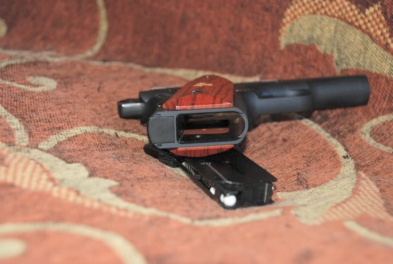

    The pistol strips to its basic components very easily, just like a real 1911.
    In the picture above, you can see how the rails had to be filed in order to fit the slide on the frame.

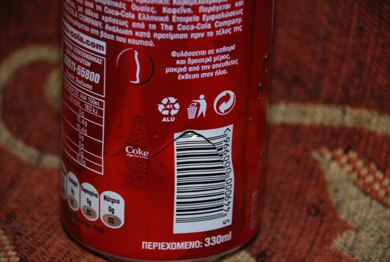

    Power-wise, again nothing extraordinary. The BB punched a clean hole on the side of the Coke can and dented the opposite side, but didn't penetrate it. I think I would invest in some extra power magazine valve on this one, and some heavier springs. I would like to see this pistol getting a little more powerful and now that it has a metal slide and frame, I do not have to worry much about damaging it.
