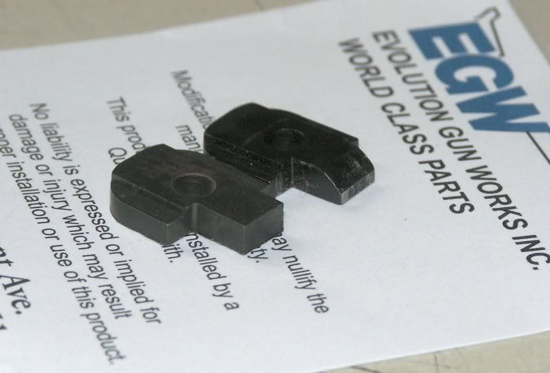

    OK folks, here are the pictures:
    This is an EGW square profile firing pin stop on the left, and a standard rounded profile stop on the right.

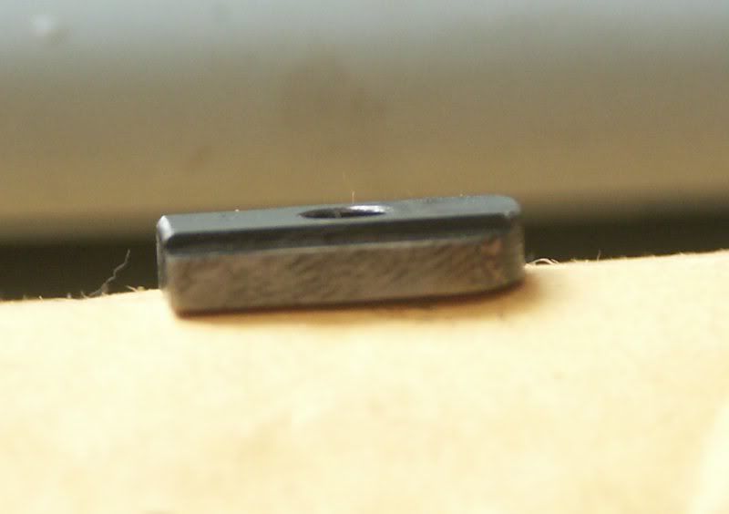

    Here is how the bevel should be filed.
    And here is how it should not be filed. This is a stop that Johnny send me.
    As you can see, the bevel I created is not straight accross the width of the stop. This was the first one I worked on, and I managed to totally destroy it. So I keep it only for playing and experimenting.
    Thank God, I always order more parts than I need, LORL.

    just wanted to ask how much metal you take off to make the cut. in the first picture the angled face is much larger than the in the second picture.
