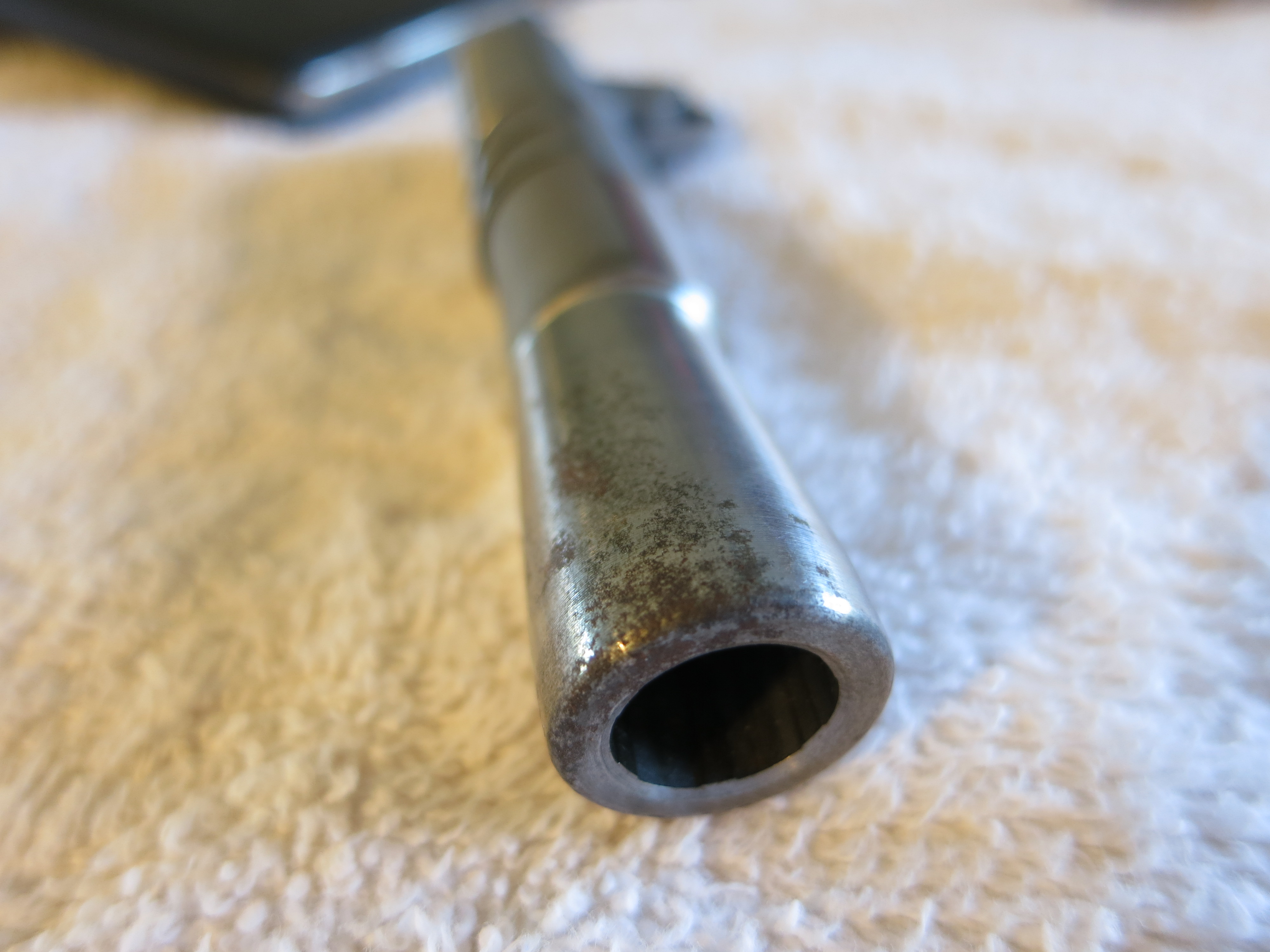

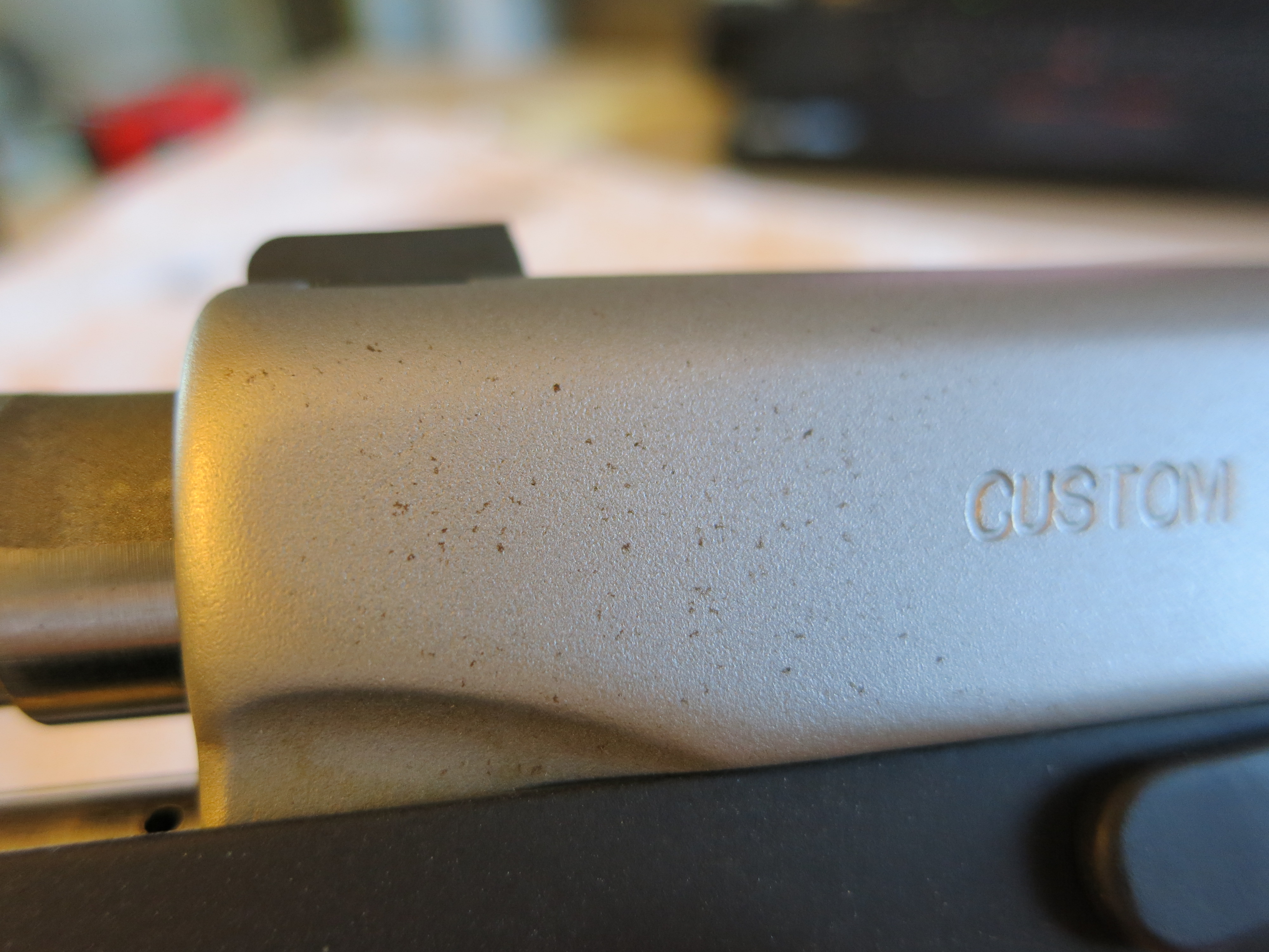

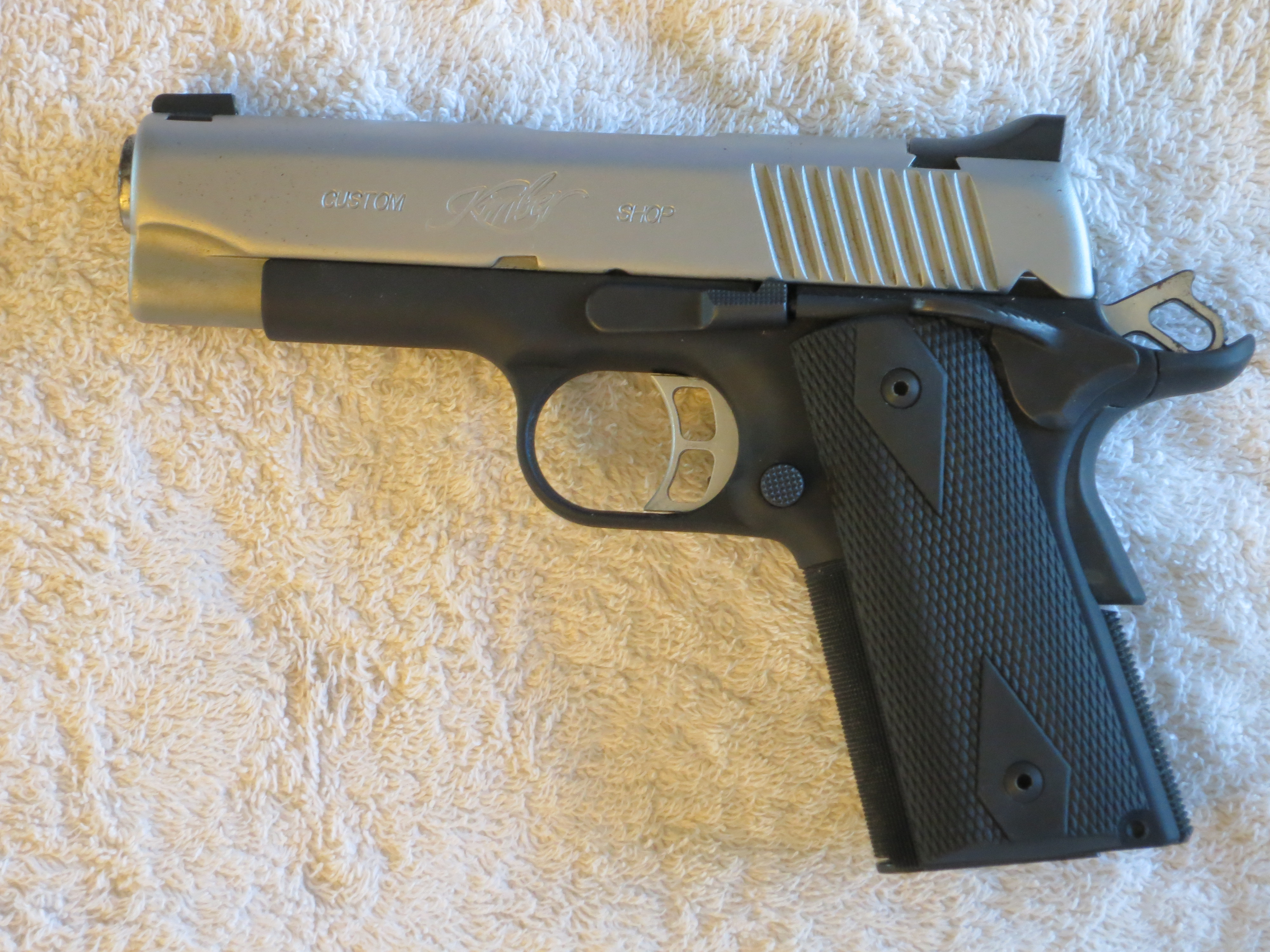

    I purchased my Kimber Custom Shop Combat Carry in 1999 when I lived in Seattle, then moved to California at the end of 2000 and the gun sat in storage for 20 years until I just recently moved to Nevada.

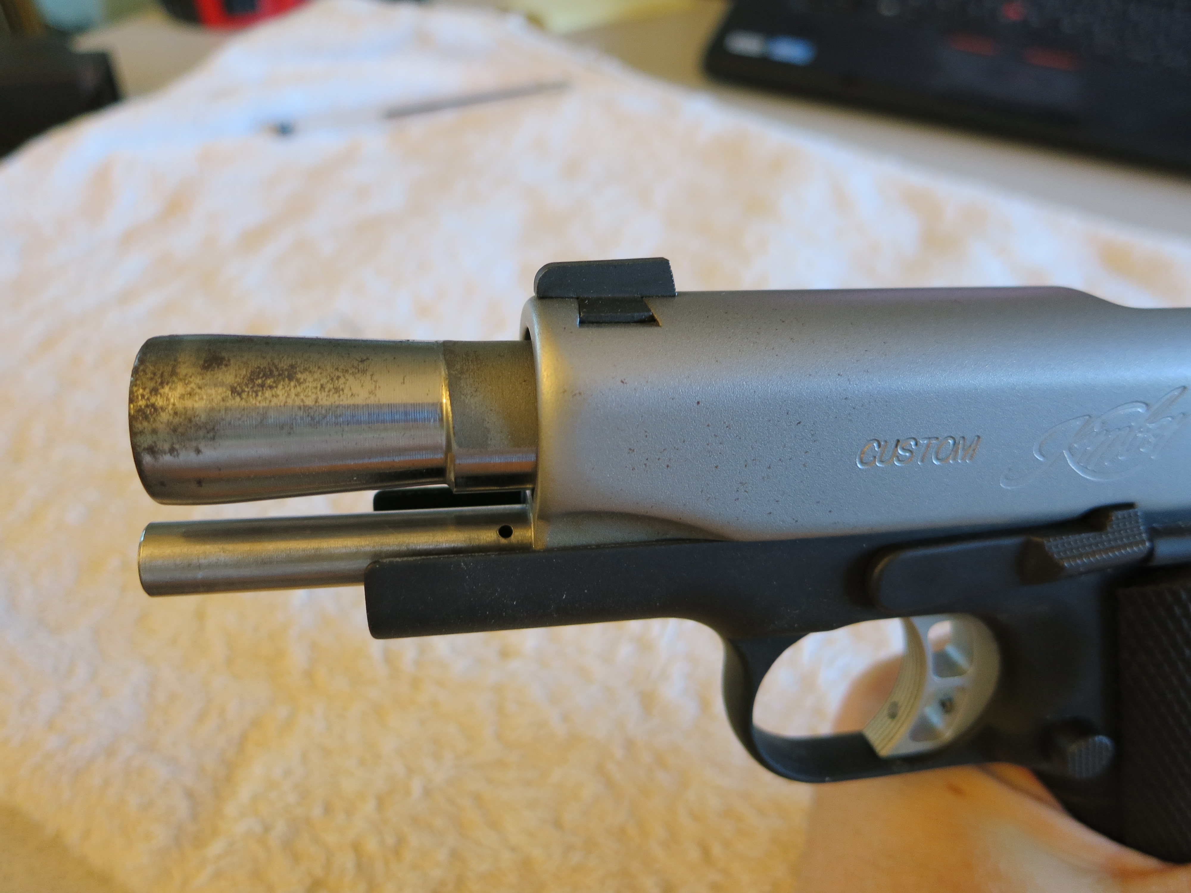

    I just did a very basic inspection of the gun and it appears to work as well as I remember, but with some corrosion showing on the end of the barrel and the slide.
    When I was shooting regularly I would clean the gun after every visit to the range. I only ever took the slide off and cleaned the basic components, never even removed the firing pin.

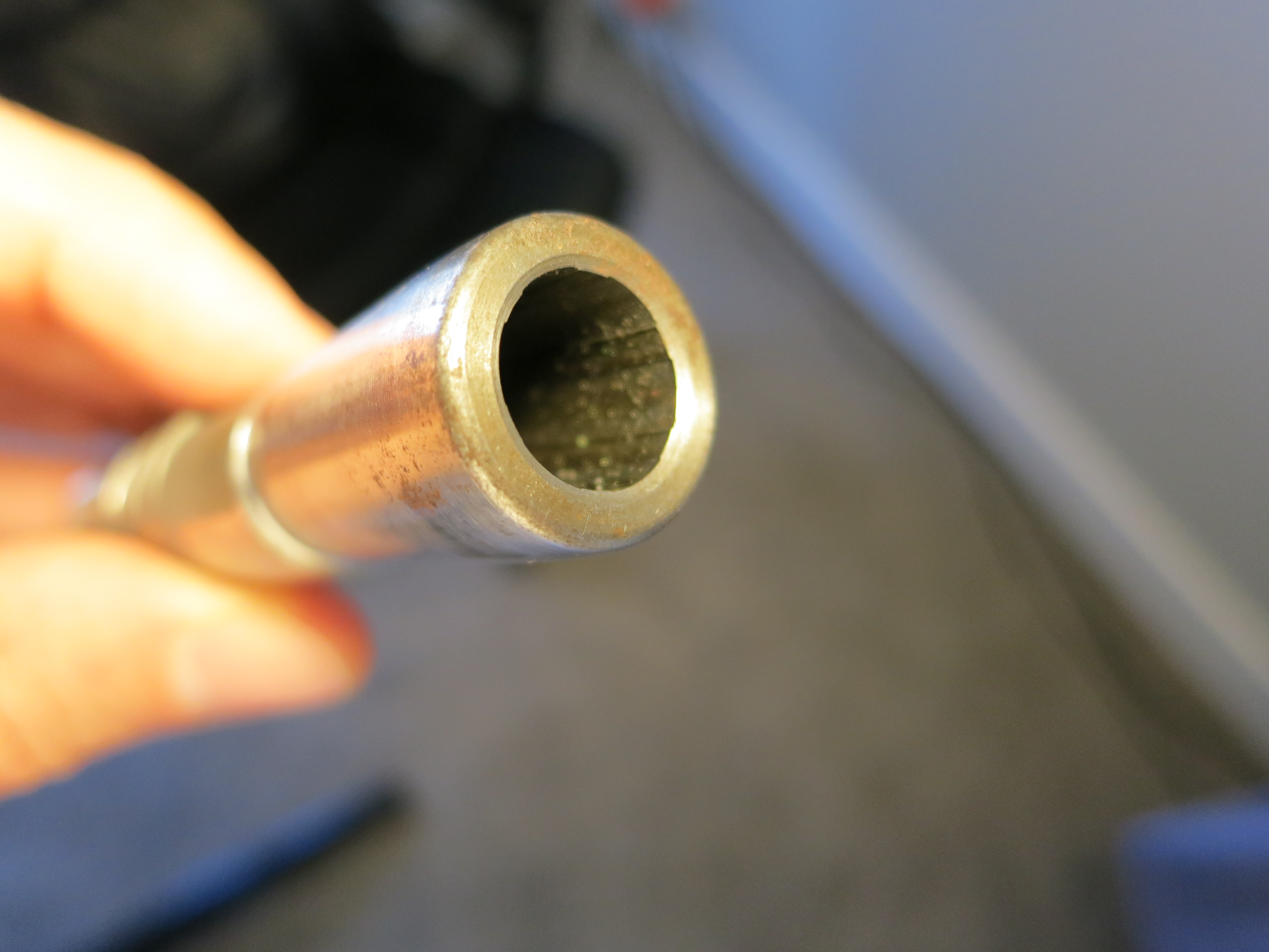

    So I'm wondering what would be a good idea for me to do before going to the range again? Is there something I should inspect for? Some extra cleaning some place? Any tips on removing the corrosion on the barrel and the slide? My first idea was to drop the barrel in some Eastwood Rust Dissolver, but I wasn't so sure this would be a good idea on the slide.

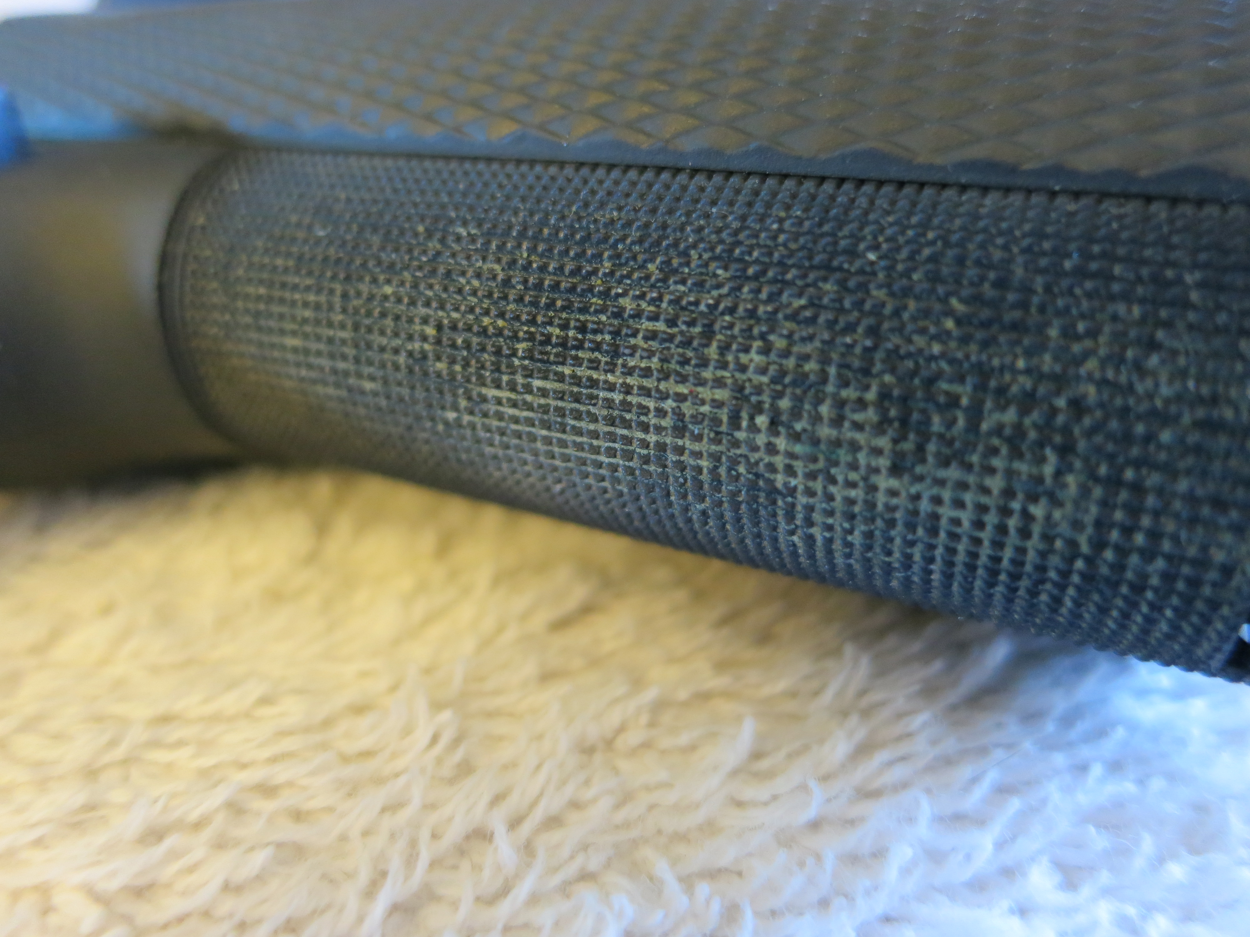

    I was also wondering if anyone has any tips on cleaning the grease and skin out of the metal grip spikes?

    First I would try Breakfree CLP, soft cloth rags and a toothbrush with the bristles cut to about half normal height. Breakfree CLP softens rust so the rags/toothbrush can remove it but usually any pitted areas remain dark. Any rust remover I've ever used etches metal.

    I would try and soak in in CLP then lightly rub with stainless steel wool to remove any remaining rust,
    Then use it, pits & all.

    If it was me I would detail strip it and drop it in a pan of Mineral Spirits ( Available in the paint department of your home store).
    Let soak overnight, put some gloves on and scrub with a toothbrush.
    Pull parts out let dry or hit with some compressed air.
    Barrel can be cleaned with Flitz.
