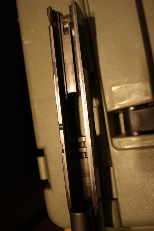

Bottom of slide dragging on top of dust cover, dust cover scratching outside of recoil plug area. I know the fit isn't particularly important, but the drag and the rattle bug me. From looking at it and reading around some, it looks like the only thing to do is weld up and refit the front of the rails. The slide is already smaller at the bottom than the top, so I don't want to squeeze it, and I can't peen the frame rails down to tighten, because then the slide will just sit lower...right?
http://i142.photobucket.com/albums/r...lideFit001.jpg

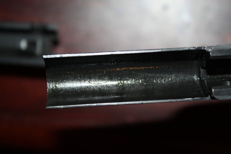

Also, what do you think made the scratches across the top of the frame rails? Almost looks like someone took a chisel to it in hopes the burrs would tighten up the fit, but they look like there's bluing in them, so I guess they've been there since new? Sorry, pic doesn't show them very well.
http://i142.photobucket.com/albums/r...lideFit003.jpg
