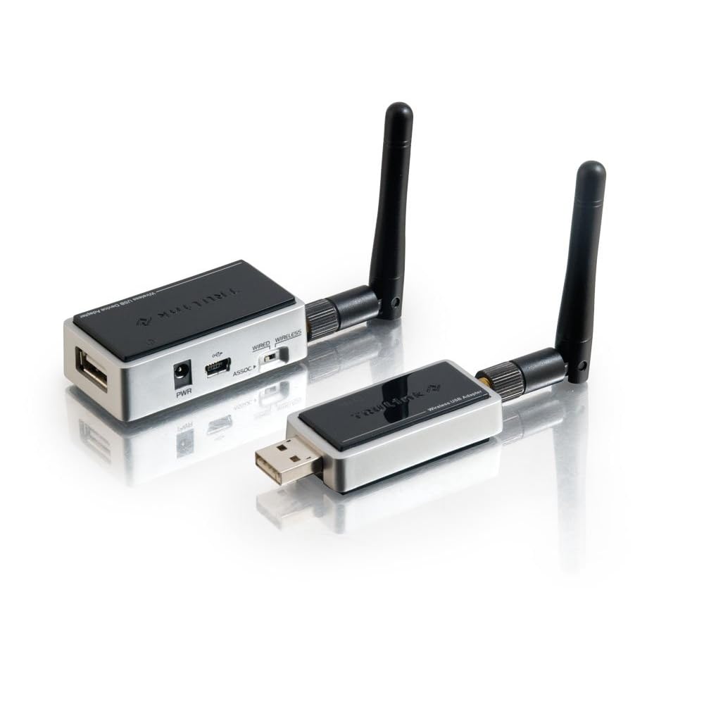

The dongles are made by "Cables to Go" and you can read all the technical specs here: http://www.cablestogo.com/product.a...=1542&sku=29571
Now, these two little boxes, do not create a WiFi network between your camera and your router, or your computer, like the WT-4 does. They instead replace your typical USB cable you use to connect the camera to your computer, with a wireless USB connection. The front one goes into any USB port on your computer, while the rear one gets connected with a supplied cable to your camera. They are supposed to allow you to create a wireless USB link, so you can connect the camera to your computer, from a distance of up to 30'. So, I ordered one of these kits (price at Amazon $87) and today the mail man delivered it to my door. Here is what is included in the kit.
The two dongles, a power supply, a CD-ROM with the software, two antennas and a very handy USB extender cable, with a base, in which you can install the computer dongle vertically.
